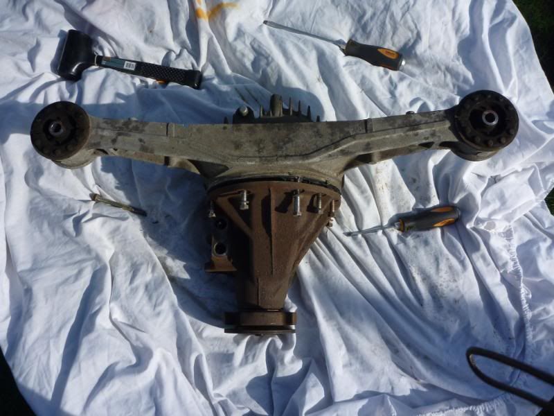

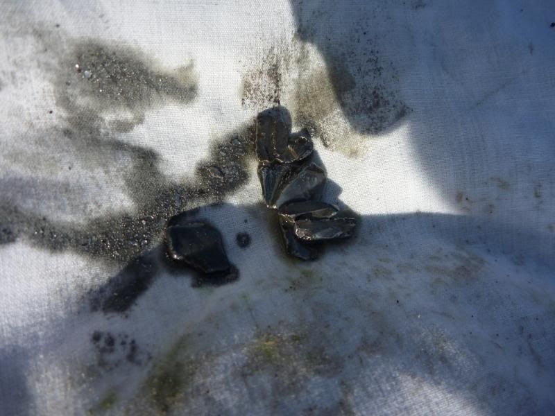

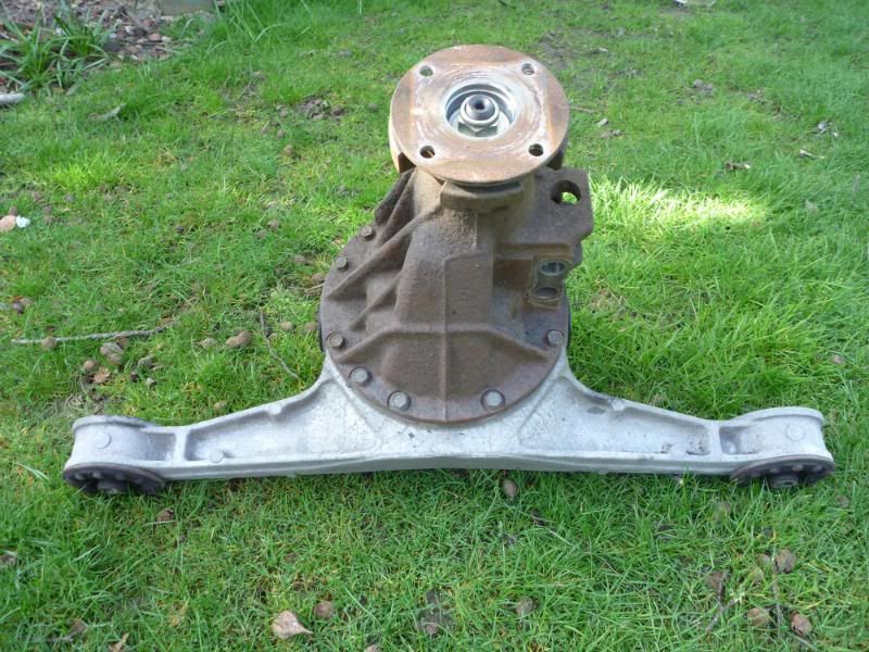

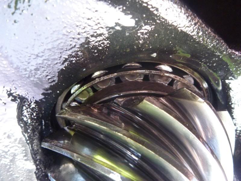

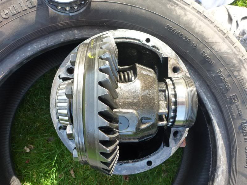

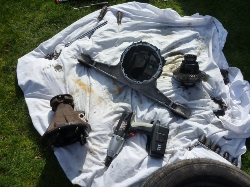

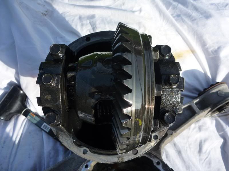

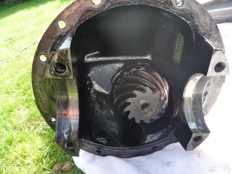

     Im glad I've found this thread
    I'm on my second diff now and this one is doing better but the tabs are still braking off even when I change the diff oil every 5k or every two track days.
    The tabs from the first Diff
    I swap this for a another second had diff I bought and took the old one to bits to look for what damage I had. since mine had start to make a fair amount of noise
    all the damage was on the crown wheel

     Ollie, you have PM

     thats fab,do you any pictures of the diff or crown wheel?the more info we have and photos the better!if anyone else out there has any please put them up,or mail them to me directly,pm me and i will give you my email .
    many thanks

     Hi Guys ive got pretty busy weekend but will try and get images of the diff for you as soon as my work load has buggered off.  I will post the images i have on my photo bucket

     Hi Ollie, sadly this is a different type of diff to the one in question- it doesn`t seem to have the problematic dished friction plates where the lugs we are talking about would have snapped off from.
    Thanks for the photos though and better luck with your next diffThumbs up
    If anyone else suffers diff failure of an LSD and the casing is opened somewhere other than a franchised Mazda UK dealer please do send your photos in. We suspect Mazda are very well aware of the problem and are only really interested in helping owners of cars whose vehicles are within warranty.
    Owners of older vehicles with this problem who still have thier vehicles serviced within the dealer network will in all probability not be told of large bits of hardened steel that may have been stuck to the magnetic drain plug while the vehicles are serviced.
    Don`t forget, when one or more of these tags has snapped off , the LSD action of the diff will have been significantly weakened and far more prone to more of these tags (8 in total) cracking off the plate and possibly jamming and causing total failure of your diff and a possible accident.
    I would very strongly advise owners to be aware of a potential cause of the actual fracture of these badly designed components, could possibly be due to rear and handbrake testing rollers at MOT time. Owners should inform the MOT tester that their car has a limited slip diff (with a known weakness) and request that brake testing rollers should not be used on the rear of thier vehicle.
    In reality a differential should easily last for at least 100,000 miles on a road car..................................

    taff eunos:
    That is the same type of diff, it has springs inbetween the sun gears! The taper rings are inside the differential element of the assembly...
    taff eunos:
     ...clamping force is via a worm-gear arrangement similar to a TorSen set-up.
    "Clamping force" is generated by friction between the taper ring and the sun gear, the springs help with this. This type of diff has no worm gear.
