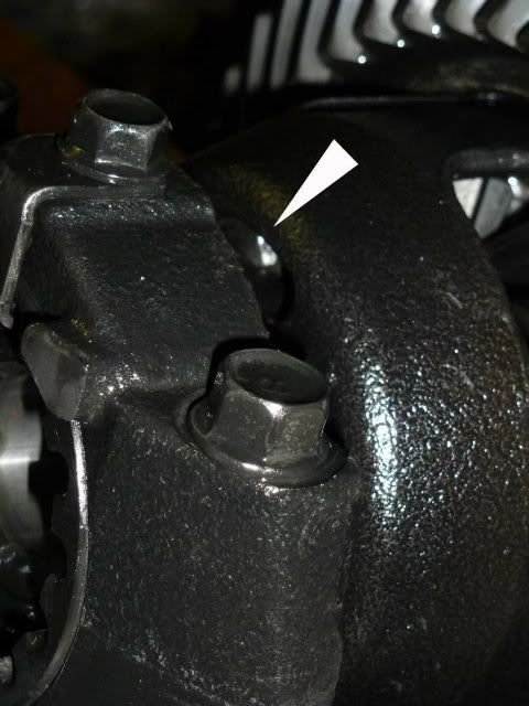

    Can anyone who's dismantled one of these diffs tell me - does the differential core just come apart when you unbolt it from the ring gear?
    It looks like it will, in the sectional drawing here: http://www.gkndriveline.com/drivelinecms/export/sites/driveline/downloads/datasheets/Super_LSD.pdf
    The reason I ask is that ages ago I bought a used 3.6:1 differential which I intended to swap for my 4.1:1 diff for more relaxed motorway cruising but only recently got round to trying to fit it.  I didn't fully appreciate when I bought it that it's the notorious Tochigi Fuji Super LSD type.  You can already guess what I found when I took out the magnetic drain plug:
    broken tab
    I took the housing off to see if the ring and pinion gears were OK - which they are - but noticed that you can just about see into the LSD through holes in the casting, and in the gaps I could see the glint of more broken tabs from the taper ring, just waiting to fall out and cause havoc.  I could reach one with tweezers but tantalisingly it just slips away:
    glimpse of another broken tab
    The arrowed glint is the edge of one of those broken-off tabs.
    Anyway, plan A (fit it anyway and cross fingers) is abandoned since I've seen that trapped debris hanging like the sword of damocles.
    Plan B was to replace the LSD portion of the diff with either the torsen core of my current diff or the core of an open diff if I can get one cheap
    But plan C is to dismantle the LSD, extract the broken bits and if the taper rings are otherwise still intact, reassemble and use it as a nearly-open diff.
    (I appreciate that rebuilding a diff is more complex than a matter of reassembly, but miata.net's garage section has a description of the procedure I think even I could carry out)
    Thanks in advance for any insights into the practicality of Plan C.

    Yes, the differential itself is dismantelable (is it a word?) and re-buildable easily enough. It's just a matter of undoing a few counter-sunk cross head screws. Undo them evenly as the cover is under spring tension.
