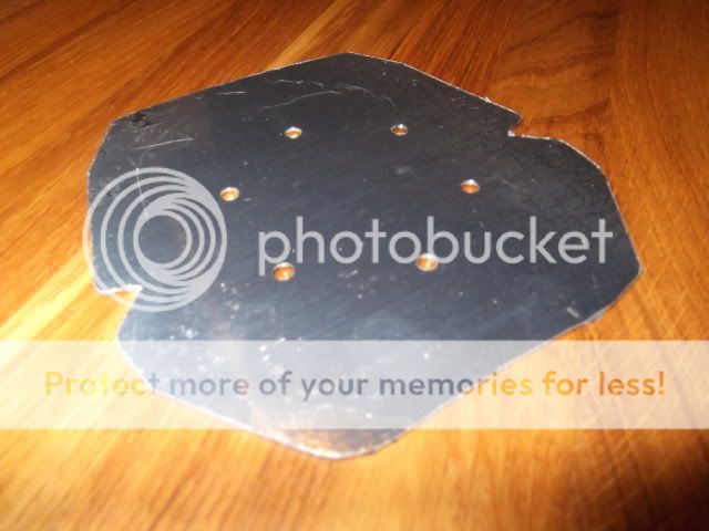

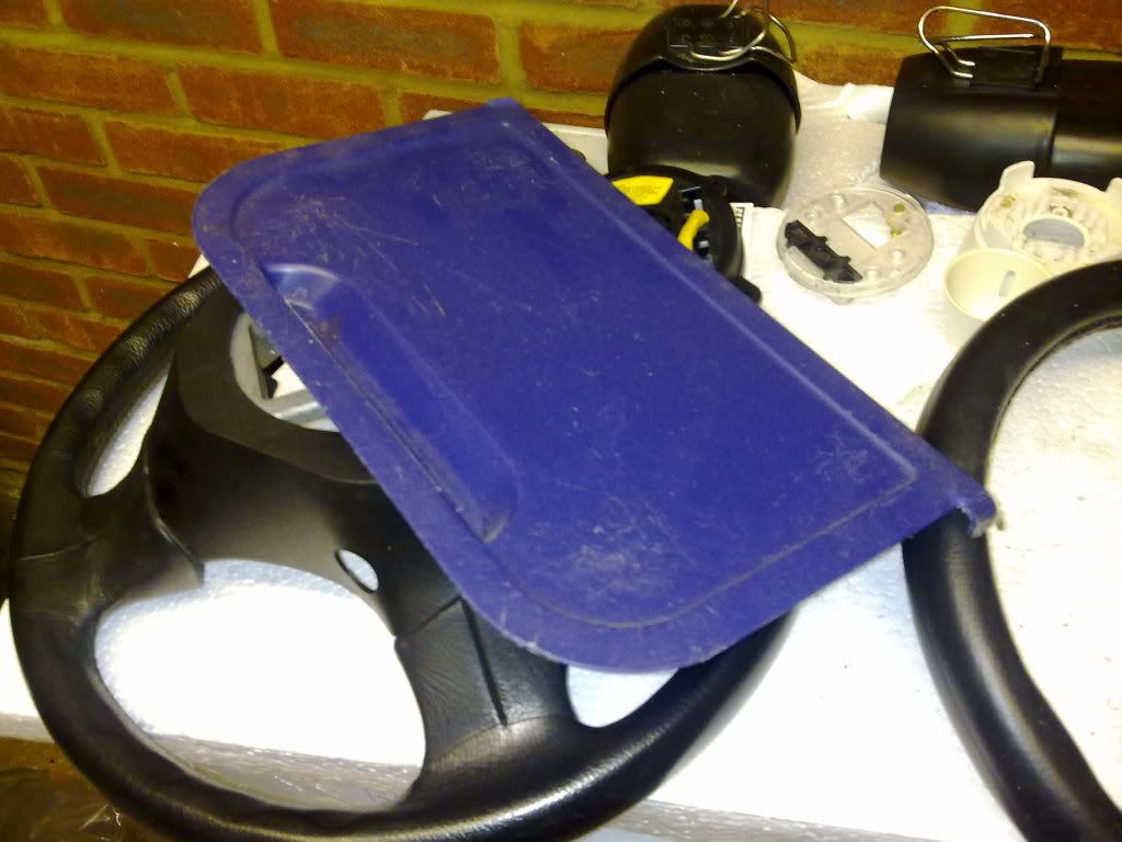

    So, in case anyone else fancies having a go themselves a short 'how to'...

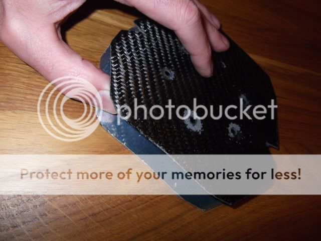

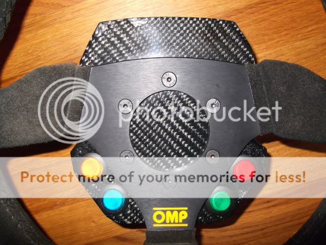

    Aluminium template:

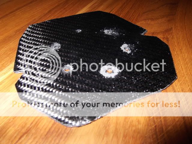

    Layered up with three layers of carbon fibre cloth; at this stage I pre-drilled the hardened carbon whilst still on the template to ensure the steering wheel would align (forgot to brush off drill dust pre photo!):
    Separate template from new blank, the better you polish the template the easier the blank will come off!

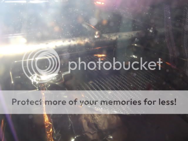

    Carbon blank is rubbed down in-between three coats of epoxy resin, baking at 80-100 degrees between coats (don't let the good lady catch you putting car parts in the oven!)
    Final prep of 1200-1500 grit wet and dry, then polish up with cutting polish (Autoglym in my case). The blank pre-fitted:
    Remove and drill holes for switches (20mm holes in this case). Measure twice, drill once!!!

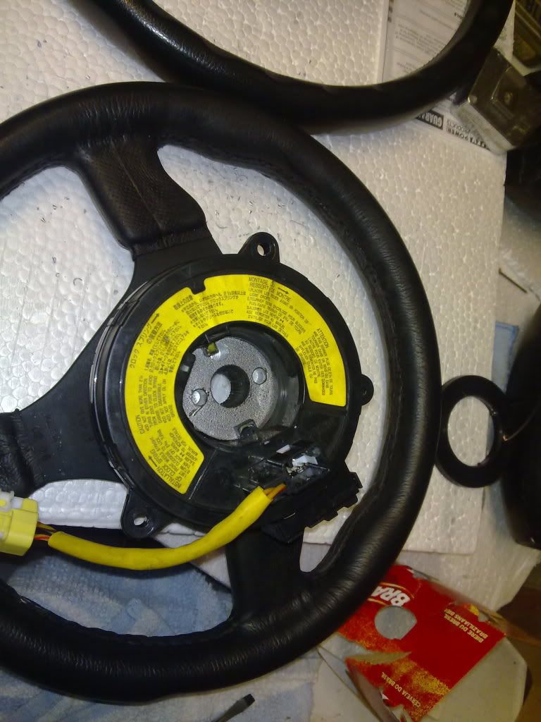

    The area to the top of the wheel will eventually house two horn buttons but slow ebay delivery and my lack of patience meant posting this thread before the wheel is fully finished!

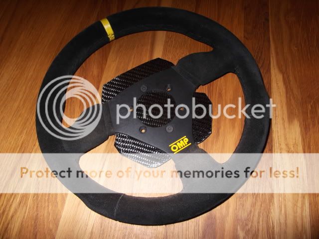

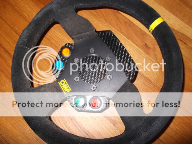

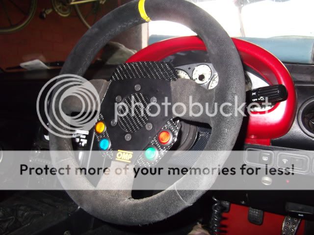

    The fitted result:

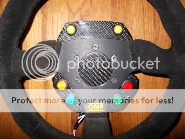

    Just have to wire up and I'm done, currently considering the following: horn (x 2 buttons), 2nd fan (I've fitted an auxillary fan for track-day abuse), wiper (normal speed), flash to pass/main beam and foglight.
    Finally, sit back and enjoy the Japanese GP Wink
    Woohoo! Last buttons arrived today and I relieved work of some wire n bits...
    Wiring is a faff, and I lack patience which doesn't help! Just have one side wired at the mo...will sort the other side once I get all the little bits of metal cable out of my pinkies, anyway, horn, fan and flash-to-pass is enough for the NEC. All switches go to a common earth and then I used a fluke to test the back of the FTP and horn relay thingies to figure out the correct live wire. Seems to work a treat. Big Smile

    Very swish!Thumbs up

    taff eunos:
    Mrs. EunosAngel says if you have any items to large for your "autoclave" you are welcome to use her new 6 ring range type fan-assisted version LOL!Wink
    Wink
    Photo proves my 'autoclave' is overdue a clean Embarassed

    peleton72:
    You can make a 80 degree oven using a fan heater and an old fridge, and if you feel like vacuum bagging your carbon you can use the refidgerant pump to generate your vacuum.
    I remember making a bonnet sized oven out of large sheets of 6" thick insualtion foam and fan heaters - it worked brilliantly.

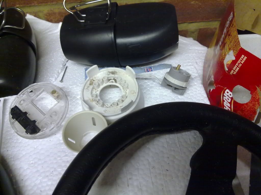

    I posted this on the P5’s forum back in 2009! It was entitled “Tonight on Bodgerama”
    I have just cut and pasted it here, so hope it works.
    A recipe for when you can't sleep and you want the horn!
    So here's the dilemma, your driving along with your sexy little steering wheel and some **** cuts you up. You rightly wish to protest via official channels and sound your horn! However since your vehicle was originally equipped with an air bag and your steering wheel has none, what do you do?
    In the grand tradition of cookery programs, how to rustle up a horn from left over bits you find in the cupboard.
    No, that's not going to fit, silly!
    Ah ha, the light comes on, or actually goes off.
    Take the freshly marinade light fitting and blend with an IKEA dustbin lid.
    A sharp knife is useful here and adult help.
    Here's one I prepared earlier.  :?:
    Continue to simmer for most of the night working with a fine selection of cooking utensils
    until all the crap has been reduced to this consistency.
    Finally pour into a serving dish and enjoy, reciting the words, "**** me, it actually works!"
