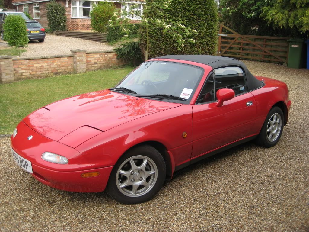

    As I bought it:
    The first little blip in ownership was a big corner of flat paint around the rear corner, not obvious in the wet. It looks almost like someone polished the whole car, then stopped when there was about 5% left to do. I've since dug deeper and found out the car had a full respray, and the sills repaired about 3-4 years ago. Not a bad result in that department! This information came when I met a previous owner at last years MX5OC spring rally, who said he'd only traded the car in as it was fading and going pink!

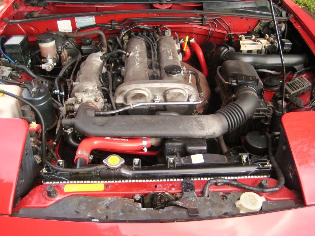

    I was looking forward to getting rid of the 4 random tyres and getting decent rubber and a full alignment done and just enjoying the car. Alas a summer of headache began, when I noticed that when driven enthusiastically the coolant overflow would literally, overflow and lose coolant, coupled with gurgling noises when turned off from hot. Starting from the basics, I did the rad cap and stat with no joy so this progressed to water pump/cambelt, engine flush and new radiator, funded by selling the hardtop for a slightly disappointing below par figure. Frustratingly no improvement. A brief ray of light when another mechanic spotted the cooling fan intermittently wasn't kicking in possibly leading to over-pressurisation led to a new temp sensor, which cured the fan but still not the coolant loss. Mark at Freelance finally spotted it had a Mazda 323 head on the block, which should be the same in theory but it seems gasket channels etc aren't a perfect match causing all my trouble. I also had to question why the head had been changed in the first place. It seems the car has been in the hands of a well meaning tinkerer, who was good enough to undertake a fairly decent restoration on the body but bodged the mechanicals. I debated getting rid of her, but a quick trip to Garath the MX5 restorer gave me a bit more inspiration when he said the car was in fairly good structural nick, so perhaps worth investing some more. The car seemed to drive fine if you took it easy so I did potter about in it, but not with much confidence and an eye constantly on the temp gauge. She was SORNED for the winter late in September.
    Fast forward to this year, a bit of saving and some of my Dad's early retirement fund made the most cost effective solution now within reach, a straight engine swap. Booking it in to a competitively priced specialist in Essex was a big relief. I decided to spare few expenses and get a new clutch and red silicone hose kit, as well as gearbox and diff oil changed. I've had the car back a couple of weeks and touch wood all seems well. The coolant levels and temperatures are solid as a rock, and if the specialist is to be believed, I have an engine with many tens of thousands of miles less use than before up the front now. It certainly feels stronger and more confidence inspiring now.

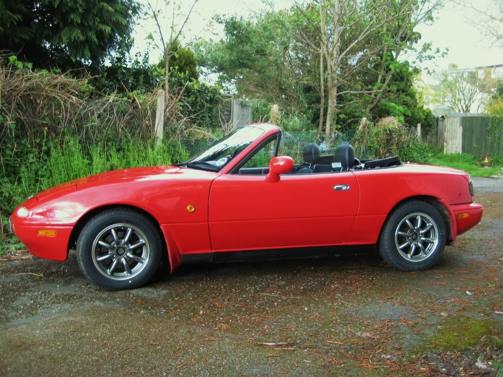

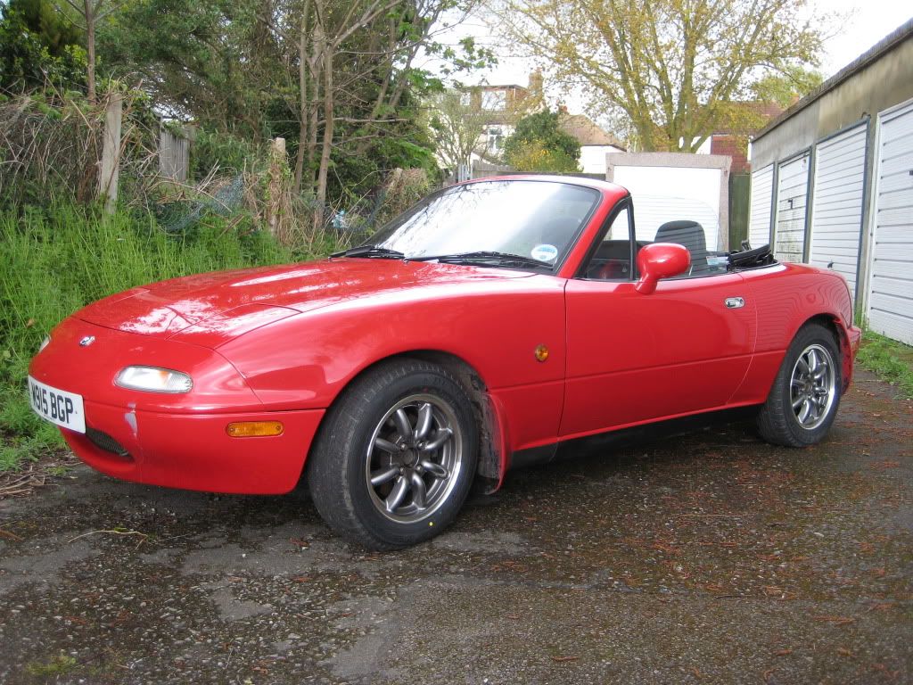

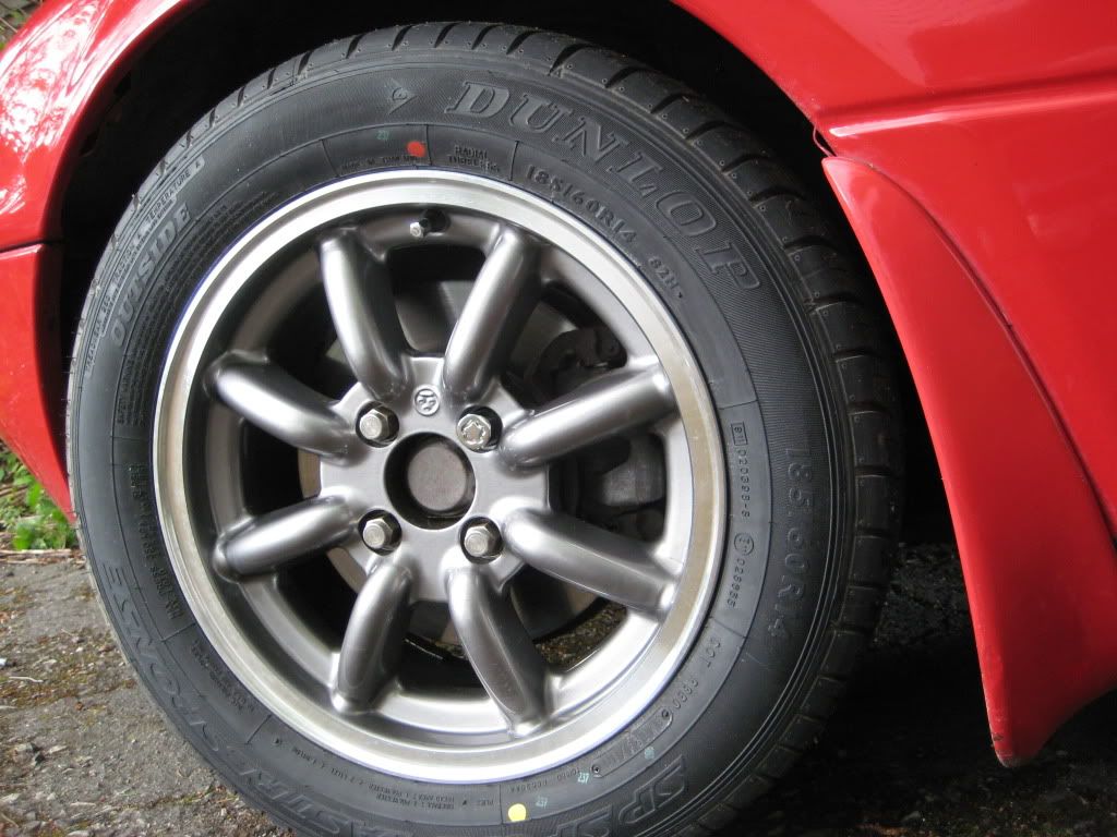

    As is inevitable once a '5 is in your possession the modding bug bites, and I'd always been taken by minilite wheels. A browse of the MX5Nutz forum turned up a recently fully refurbished set of 14" RS Watanabes in light anthracite with polished lip, being sold be a '5 nut within a few miles from me. Yeah, I stalled for a bit but then decided it was too good not to miss. Much um and ahhing over tyre choice, and they were quickly framed by some Dunlop SP FastResponses. A wheel alignment on a hunter didn't quite prove the next best thing in sliced bread, but some very questionable and uneven final readings (although "in the green") mean either a moan and trip back or the extra expense to MX mecca of Wheels in Motion.
