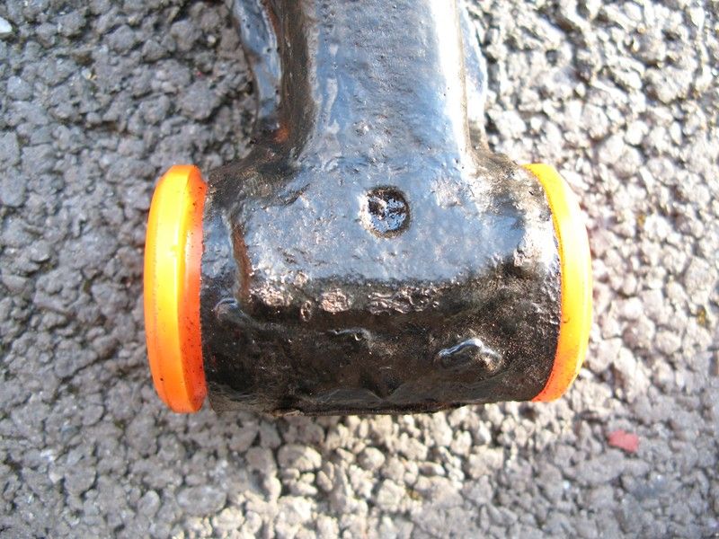

    I'm in the process of fitting floflex polybushes and am having issues with the fit. Some of the bushes just seem too big, i thought I'd check on here that I'm not missing something/doing it wrong before getting in touch with floflex.
    The roll bar and upper wishbone bushes are fine, it's the rear lower wishbone giving me problems. The bushes stick out by a couple of mm (see pic of lower wishbone below), has anyone else had this problem?

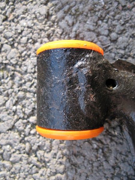

    Compared to the upper wishbone:
    upper wishbone bush
    The bushes cannot be compressed in any further - the two halves are completely flush in the centre.
    Even the upper wishbone where the bushes don't protrude it's a much tighter fit when fitting the wishbone to the subframe. So tight I'm worried that the wishbone will struggle to pivot like it should do, surely the extra stress won't do the ride/suspension any favours?
    Compared to other bushes this kit was cheap - a sale price of around £90 for both front and rear wishbones and anti-roll bars. A case of you get what you pay for??
    Mk 1 1.8, 1998, completely standard

    I've been reading up on these today, it looks like there are plenty of people with fitting issues, both on here and various other car forums. When I compared prices I thought along the lines of 'surely polybushes are going to be all the same, they're just lumps of plastic', clearly not! Confused
    Would it be a bad idea to trim the bush down so that it fits? At least this would allow me to finish the rear suspension and get back on the road.

    I found the same problem three+ years ago when I fitted mine but they slotted in without too much fuss and made for a good, tight fit.
    No issues 3+ years on...and they're still very orange!

    Thanks for that. I'm going to do what he did and trim them or use a belt sander to take a mm or two off each bush. Will see how it goes this weekend.
