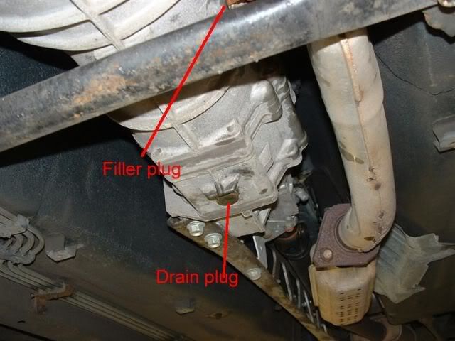

    Here's the location of the drain plug:
    Drain the old oil (24mm socket required), clean the muck from the magnetic drain plug, then take out the refill/level plug on the side of the box (16mm socket will suffice).
    Replace the drain plug (use a new sealing washer, it's identical to the oil drain plug one).

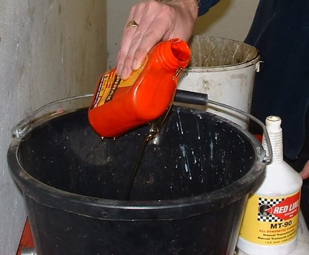

    Try to obtain a flexi plastic bottle like this one:

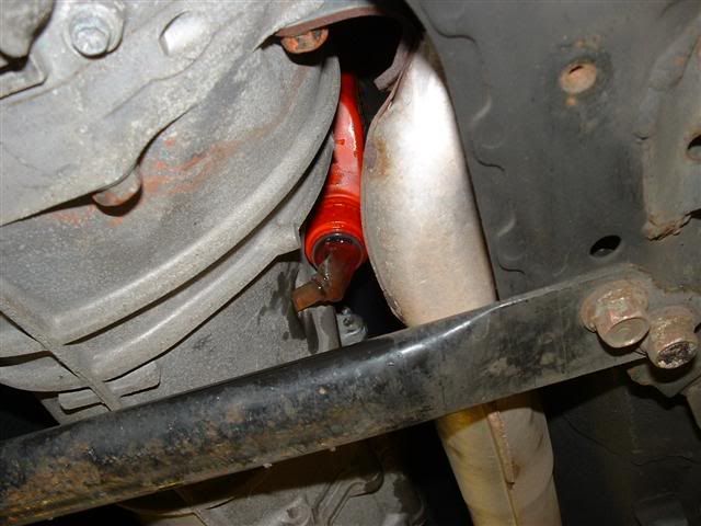

    Manouver the oil bottle up alongside the gearbox, above the filler hole, like this:
    Keep filling, until the oil overflows from the filler provided that your car is level to the ground this will ensure the correct oil level in the gearbox.
